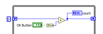

You should learn about shift registers (or feedback nodes) to keep count. Initialize with zero and just increment the value when ever the latch action button is true. There are plenty of examples in the forum to count button presses.
Here is one possible way (assuming the button is latch action).

Okay so I am sitting here drawing a blank... What is the green structure in your image and how does it connect to the button?
Message 6 of 9
(7,524 Views)
The only green thing is the button terminal (maybe you are used to see them as icons? same thing!) and the green wire. The next node is "boolean to (0,1)".

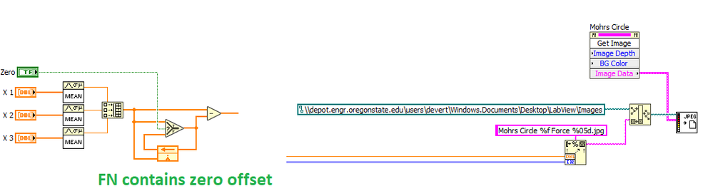

Hey man I had just figured it out right before you replied! I have the counter and the file out put all set up now and everything is working great. I uploaded it again just so you can see the final result. Of course I have TON of cleaning up to do and then taking into consideration what you said about the zeroing function but for now it will do what I need it for LAB tomorrow!

  • Your counter indicator should not be U64, seems excessive. (Try I16 or I32)
  • X3 Should be DBL, not EXT.
  • I told you to use build path. (treating paths as strings and using string to path breaks the code on other platforms (mac, linux, etc.))
  • You can do the entire filename with one format (formatting a floating point number as %d will drop the decimals, not sure if you want that. For the sequence number, you should do zero-padding (e.g. %05d) so alphabetic sorting of the files will keep them in numerical order.
Here are some ideas to get you started:
