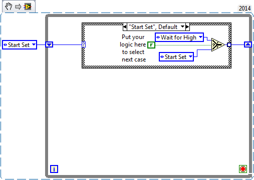

OpenG comes with a boolean trigger function, I'm not sure how useful that would be though. If you values change in a somewhat continuous way, (i.e. in steps of 5, not 80) then you can probably easily catch it with a case a structure. The next case would be held in a shift register of the while loop.
Case 1: If x<25 --> Case 2, else Case 1.
Case 2: If x>60 --> Case 3, else Case 2.
Case 3: If x<20 --> Case 4, else Case 3.
Case 4: Increment set counter then back to Case 1.

It could look something like this. I haven't filled in all of the cases for you or put in any logic for picking the next state. Also, if you use those enum constants, it's always a good idea to make them type definitions. That way if you add or remove states, the constants will be updated everywhere. Right click >> Make Type Def. Right click >> Open Type Def. then save it near your VIs, or in an appropriately named subfolder.
