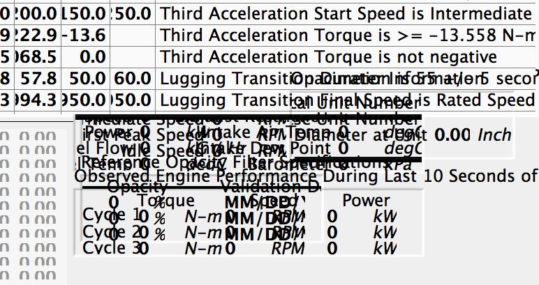

I can open it on my Mac in LV 8.6.0.
It has some serious overlap issues in the lower right hand portion.  (And that is ignoring the common font size issues seen when changing platforms).
Is there something you know needs to be fixed so you can use it?  Perhaps I could do it for you and post the modified version here.

Yes, I know about the overlap stuff.
Like I said, I was working on it and re-arranging stuff on the page when I discovered the bug.
