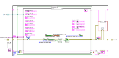

Im looking to create a progress bar for the duration of my program from when it starts to when it finishes

Hi KJ,
What have you tried and where are you stuck?
How do you define the progress? (Is the "duration" of your program always the same?)
Recommendation:
Before adding more code to your VI I suggest to cleanup the current code!
  • Why do you copy the value of those controls into their own local variables?
  • Why are there indicators without labels in the block diagram?
  • What about left-to-right wiring with straight wires?

In regards to the progress bar - I want the duration of progress bar to increment when each state is completed from the start to finish

Divide loop steps by (maximum loop steps/100) and wire this result to a horizontal progress bar.
note: this only works for this VI, if you want progress bar in another VI you'll need to use some kind of a global variable.

Hi KJ,
Use a shift register to hold the progress value.
Add an increment in each state.
Update the progress indicator after (or before) the actual state…

You have a state machine, which, if properly implemented(!) can go from any state to any other state ad infinitum. There should not be a defined downward spiral, else you would not even need a state machine.
If there is a subsequence of states (known number and order), you can create a progress bar for that section. There should not be a progress bar in the idle state.
Please be very specific in your question and actually attach some code. Pictures are NOT code.
As Gerd already pointed out, you have some silly bad habits that tell us that you are a beginner. Wiring a local variable to its own terminal is just plain wrong!!! Do you understand why? Do you know what a local variable really is?
