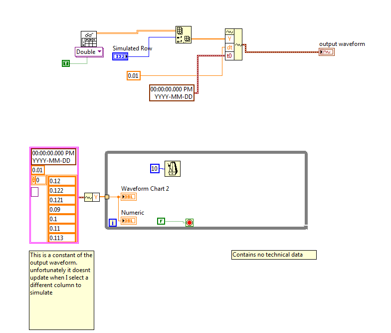

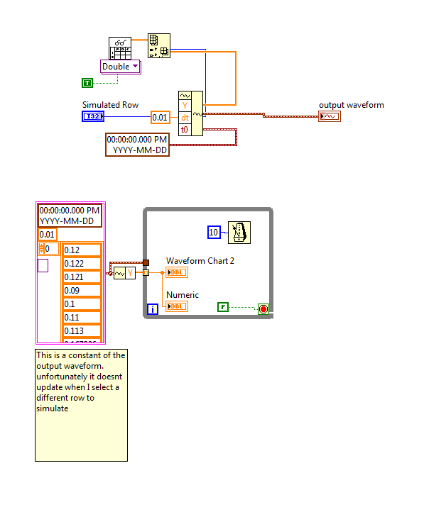

Thats the only way I was able to simulate a signal, but thats not working the way I wanted. Capture.PNG

So thats what I have so far. It can display me the chart of the data but it is not like a real signal I can monitor or work with. I think its the wrong approach for archieving a simulated signal from an excel file containing a column of numbers (saved process data).
