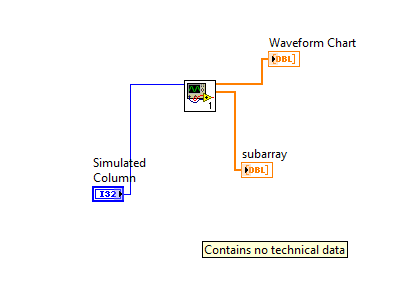

The endgoal should be to create a SubVI with one output like a DAQ that acquires data from a running process, so I can just replace my SubVI with the DAQ when integrating the monitoring software into the process. When I create a SubVI of the code it doesn't work anymore. I don't get why. Are there some more steps needed to achieve the painted SubVI?

Well, if you are doing it with a subVI, you should not have the loop.  All the subVI should do is read the file and output the desired row.  That would be the equivalent to a single DAQmx Read.
