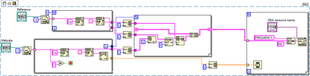

Hello
I took the liberty to improve your code arrangement, without changing any single function.
This will help further developers to easily analyze your code.
Hope this helps.
[Edit: Image attached to save some clicks]
Mondoni
(3,206 Views)

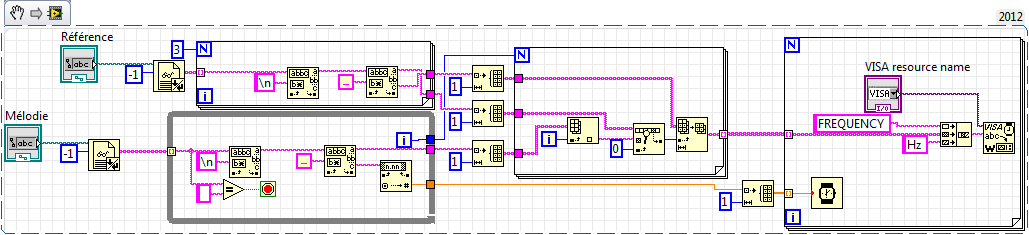

Hi claudeuntel,
Your array contains just the last note because at each for loop iteration a new table is created.
You have to send the table you created at one iteration to the next one.
To do this you can use shift register.
I didn't have tested the VI below but it should looks like that.
