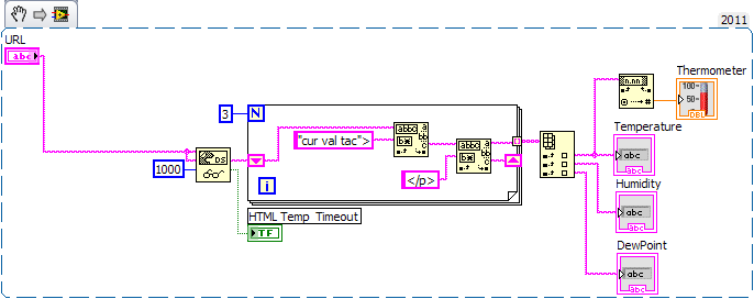

Below i have attached the code and the HTML code from the sensor. If you have to recommend anything it will be usefull for me. I have another problem now. If you see in the HTML code you will see that i have three different values to export(temperature, humidity and dewpoint) but all of them have the same regular expression in order to request in my code. Do you know how is it possible to solve this problem because always i take the same temperature value for three of them.

Why so complicated?  You need make only one DataSocket request for the HTML, not three, and there's no need for the variant functions.  Parse the HTML in a loop to get all three values as shown below.  I haven't tested this because I'm not willing to retype the text from your JPG screenshot just to see if it works, but if it's not right it's at least pretty close.

Sorry but i cant see the picture. Is it possible to re-send again???
Thank you
Message 7 of 8
(4,832 Views)
Not sure why you can't see the picture, but here it is as an attachment.
