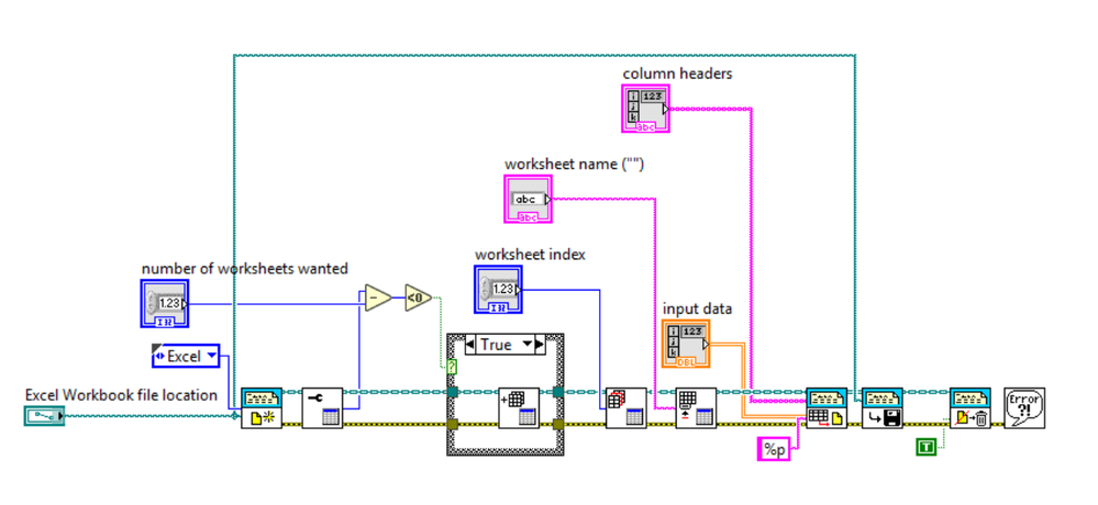

This is my VI:
This is the error:
I also get the following error:

Hi dilge,
This is my VI
There is no VI, just an image…
This is the error
How is this error related to not being able to provide a filepath as written in your first message?
Did you check any of the reasons given in the error message?
Why do you need to write any data into the XLSX file when you just want to create it?
As you didn't attach your VI we cannot check this for you. Try your best!
When you want to create a new file then you should not provide its path for template usage!

Okay, now the VI is attached. It also writes the data to a specific worksheet, I used to use this as a subVI for saving data, but I forgot how to create an excel file in the first place so I cannot use this now.

OKAY, I got it handled. I shouldn't have used the template input for file path, you were right. 🙂 THANK YOU
