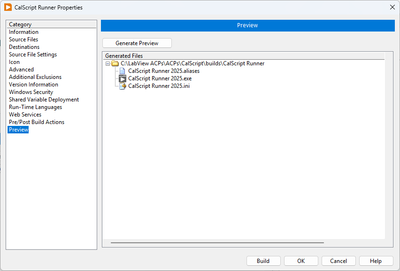

Create application with multiple LLBs
Here's the preview:

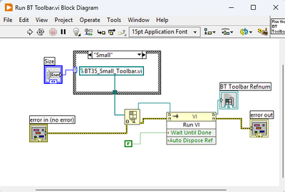

The VI is in the attached library... BT3500.llb . Run BT Toolbar.vi
Message 28 of 39
(2,027 Views)
Block Diagram of Run BT Toolbar.vi
Message 29 of 39
(2,008 Views)
So, is the VI mentioned in the case structure part of the project?
