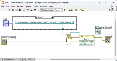

@TLamb64 wrote:
Block Diagram of Run BT Toolbar.vi
I have a feeling this is a dev/exe path-issue. Replace that Path constant with a Static VI ref and i'm sure LV will find it and solve it for you.

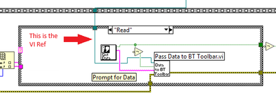

This seems reasonable. Unfortunately, I don't know how to do this... The application is designed such that the toolbar and the tab control run independent of each other, with the tab control sending data to the toolbar. Hence the need to obtain a reference to the toolbar.  The only terminal on the bt35_small_toolbar VI is the Data terminal.

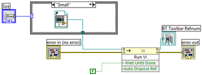

In a previous reply, someone said "I have a feeling this is a dev/exe path-issue. Replace that Path constant with a Static VI ref and i'm sure LV will find it and solve it for you." This makes sense to me, so I changed the path reference to include the complete path and llb. This did not solve the problem.
So probably I don't know what she meant by "Static VI ref". If she meant just to place the BT35_small_toolbar.VI on the diagram and wire it up, I can't do that because there are no terminals to wire to. I tried just putting the VI on the diagram, without any wires, and that causes the whole program to just hang, in the dev environment and from the executable.
The toolbar and the tabbed folder are supposed to run independently at the same time. The tabbed folder uses the toolbar reference obtained by Run Toolbar.vi to pass data to the toolbar.
Run BT Toolbar.vi gets a reference to the bt35_small_toolbar.vi. So I guess it's what's called a Dynamically Loaded VI. Since bt35_small_toolbar.vi get loaded dynamically, it does not show up on the dependencies list. I added bt35_small_toolbar.vi to the project and then added it to the Always Include. Still doesn't work.

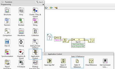

This is a static VI ref
Put it on the Block Diagram and drag the VI for which you want to create a static VI reference onto the placeholder.Or right click and Browse for Path...
Now you do not need to worry about including the VI in the build spec anymore. LabVIEW knows about it and includes it automatically.

Thank you so much! I didn't know what a Static VI Ref was... now I do! The vi shows up properly on the dependencies list, and displays and works correctly when I run the executable. So very thankful for the answer... now I can start working on what I initially started to do!
