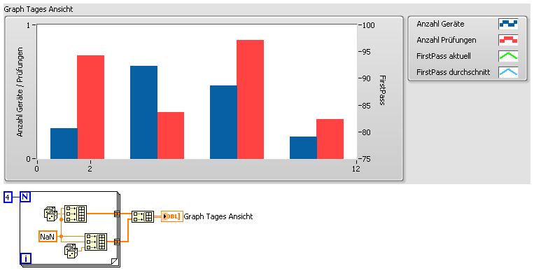

Is it possible to create a diagram like the one I attached? It was built in Excel and I'd like to have it in LabView.

Well I already tried but couldn't set two bar plots next to each other.
Any suggestions?

Hi Yves,
what have you tried so far?
I can set bar plots next to each other, like shown here.

Hi Gerd
I'd like to have two separate bar plots for each time step. Blue is a channel and red another one.

Hi Yves,
that's ok. In my example picture (lower right corner) I had more than two bar plots next to each other…
What's your problem? "I'd like to…" is just a "wish", but no "problem"!
What have you tried before?

Thank you for help.
Ok, like is wish. Then I have a problem 🙂
I have attached a the test vi that I have build to try to solve the problem.
Somehow I also haven't found a way to display the values in another way than the listbox.
Yves

Hi Yves,
you might refine this to your needs:

Thank you Gerd. I'll modify the goal a litle bit and with this solution it'll be fine.
Yves
