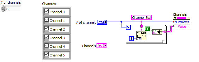

Use an array of clusters, each cluster containing a checkbox and a string indicator for the name, then resize the array and array container programmatically as needed.

Here is a very simple example
Thank you so much, It is just what I needed.
(7,725 Views)
OF course you should "disable, not greyed"  the string so it acts more like an indicator and cannot be modified by the operator at run time. Only the checkbox should be enabled. Modify as needed.
If the array size can get big, it might be better to enable the scrollbar and keep the number of visible elements constant. A control that changes it's size significantly at runtime is often not compatible with a nice UI. (e.g. You suddenly might get overlap or it might extend outside the visible front panel area.)
