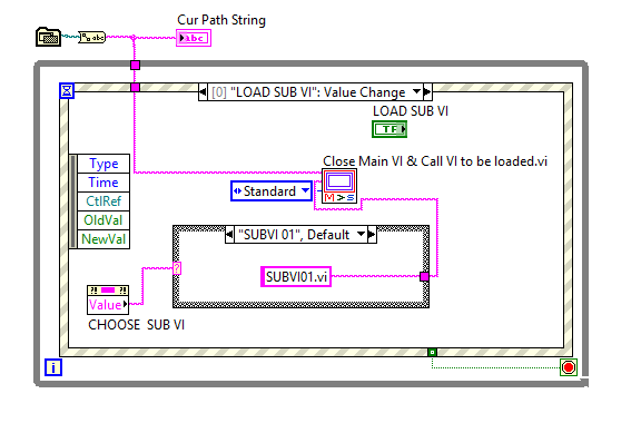

2. Inside a Event structure this SUBVI01.vi gets loaded and MAIN.vi is unloaded by another sub vi called "Close Main VI & Call VI to be loaded.vi" .

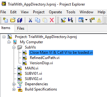

3. The reason the EXE fails is ( if I dont use a flat file structure )  because the "Close Main VI & Call VI to be loaded.vi" resides inside a folder called "SubVIs" and in the EXE mode,  this folder is not being seen by the application. I am providing the snapshout of the Event structure and the Project file structure to help understand. One way to overcome this is to move all VIs inside the SubVIs folder on to the root folder. But this will be a mess in my final app as i have hundreds of sub vis.
That is incorrect.  The VI is in there.  It just is not finding any VIs at the path you gave it.  If you were using proper error handling, you would see this.  From my observations, when using the 8.x format, VI Server goes ahead and looks inside of the executable in the supplied folder.  This seems very weird to me.  What I propose is update the "Close Main VI & Call VI to be loaded.vi" to supply the folder.  Use "Current VI's Path" and strip twice (once for the VI name, again for the subVI folder).  This will give you the folder of the main.

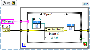

The simplest way I know how to accomplish what you described (and thank you for such a clear description, by the way) is through sub-Panels.  The idea is that your Main consists of its controls/indicators, kept "out of the way", with the space occupied by a sub-Panel structure that will show the Front Panel of whatever you wire into it.  What you wire into it is a Static VI Reference to the sub-VI that you subsequently run.  Here's an example:
If I specify "Open" as the VI Name I want to run, this Case puts the Front Panel of Open into my sub-Panel, then runs Open.  Notice that because I gave Open an Icon, this code is more-or-less self-Documenting.  If I had a dozen sub-VIs to select, there would be a dozen cases with similar code.
The cool thing about this is that (a) there are no addresses to worry about, so (b) this works equally effectively in Development Mode and when built as an Executable.
There are other ways to do more-or-less the same thing in LabVIEW, though this might be the simplest.  Look up (in LabVIEW Help or Google or the Forum) "Plug-in Architecture".
