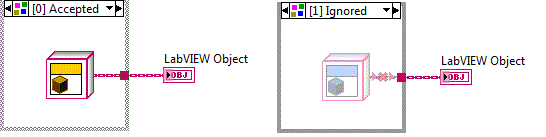

I try to study malleable VIM but cannot get something here. This is my malleable VI. Just two class constants in two different cases.
However, only one can be used in main VI:
If I change order of frames in the malleable VI, first instance of the VIM becomes connected with broken wire.
What do I do wrong?

VIM files change their outputs based on their input terminals.  If they don't have input terminals, or they do but they're not used... you always get the first unbroken case from the type specialization structures in it.
