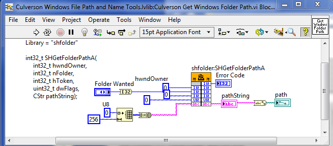

Search failed to find "shfolder" previously from "shfolder" +=+ Caller: "Culverson Windows File Path and Name Tools.lvlib:Culverson Get Windows Folder Path.vi"
I don't think "shfolder" is the problem, because the hang is not in this area of the code.
Also, the "shfolder" shows in ALL FOUR cases.
The "shfolder" mentioned is in this VI  - don't recall where I got this code from.
