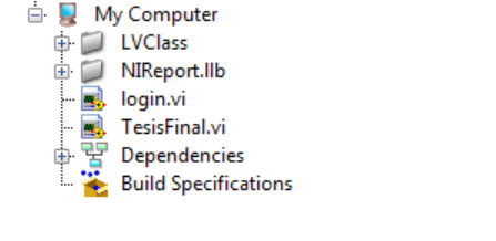

Where I chose what VI starts first? I have to change something in the " Ladder" or something like that?
(4,113 Views)
Why does your Project include the NIReport library and LVClass?  Also, I strongly recommend you create an Icon (using the Icon Editor) for TesisFinal -- it will dramatically improve the readability and "understandability" of your routine "login" (by getting rid of that big Question Mark).
Bob Schor
(4,105 Views)
Yes, I'm doing it, change icon for TesisFinal, but it doesn't help me to chose LOGIN to starts first.
