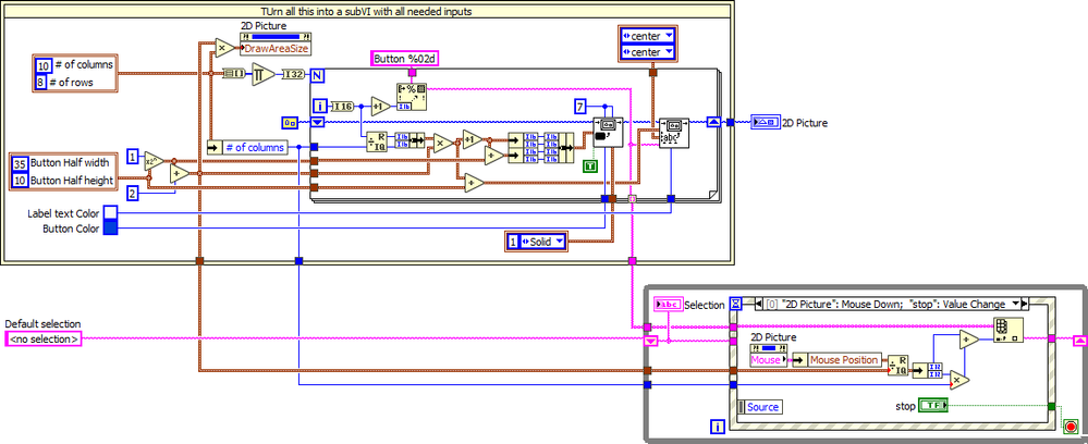

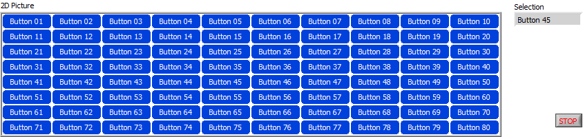

Creating a cluster control (or radio button control) with 100s of individually named and labeled buttons is just way too tedious and inflexible.
As mentioned earlier an image would be much more scalable. All we need is a reusable subVI to create the "image" of a button array and now we have full control over size, #of rows/Columns, button labels, button and text colors, button sizes, fonts, etc. etc.
If the first click should instantly exit the subVI with the selection, the code would be even simpler! (not shown)
For a more general case, it would be easy to recreate the image with each mouse interaction, e.g. to toggle the color of the clicked "button". The possibilities are endless.

Hey guys! Thanks for the help. This was my first topic in this forum. @altenbach next time will try to stick to your suggestions regarding problem description! I marked the ButtonArray.vi as solution 🙂
