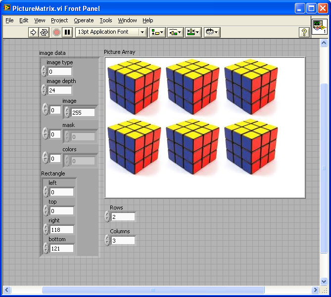

Something like this should do: (Populate the image data cluster in the usual way, ie. Read From JPEG/PNG/etc)

Wow, this looks great!!
Is there any chance that you can upload that file to me somehow?
Maybe post a link to somwhere you upload it to?
I ask because other than the flattened pixmap I'd don't know most of those express VIs..
Thanks!
Message 5 of 9
(6,451 Views)
If you have LV2009 you can drag the image with the code to your block diagram (it is a snippet).  If you are using a previous version, let me know and I can save it for an earlier version.

Those little "boxes" (key word being little) are simply called sub-VIs.  Express VIs are big blue abominations that take up valuable real estate and purport to make your life easier.
Here is the VI saved to LV8.6
