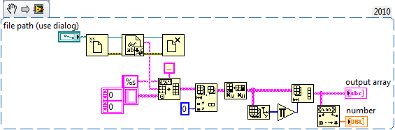

That's a fairly straightforward operation, since LabVIEW has a goodly selection of string and array manipulation tools.  The attached code is in LV 2010.
The VI reads the entire file (you may want to chunk this if you have a huge file).  Using the spreadsheet string to array primitive, this is converted to an array of strings using the space as a separator.  The first column is deleted, the array transposed, then reshaped to a linear array.  If you have further questions, let us know.
