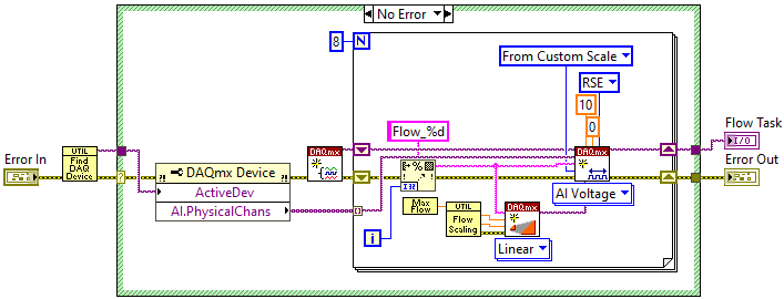

Here's an example of creating a Task for some Flow Meters, where I wanted to scale the (voltage) input from the USB-6001 to L/m, specifying a Maximum Flow, and using a linear scale to give me Slope and Offset.  The first sub-VI ("Find DAQ Device") implements the points of the first two Bullet Points, and this sub-VI does the rest of the work of building a Task that takes 8 channels worth of data.
Bob Schor
