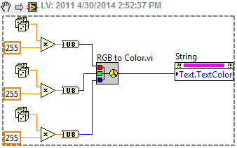

Just out of curiosity - I'm trying to make a string display random colors. My understanding is text.textcolor accepts a hex number in the format "RRGGBB". I"m doing the following, but I'm not sure that this is right. Can someone check and let me know?
Much appreciated.
LB

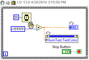

If you're looking for a truly random color, there is no need to build the RGB components individually.  You can just generate a random integer within the color range you want to use, valid numbers should be 0-16777215 (decimal), 16777216 is used for transparent objects but can't be used for text.
Tom L.

You need to create a binary 24-bit number to give the color. Labview provides a VI (RGB to Color.vi) to create a color based on 3 8-bit numbers in the sub-palette Graphics & Sounds / Picture functions. See below
Marc Dubois
