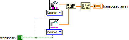

Hi novice,
@LabVIEWnovice99 wrote:
I am unable to merge the the two together to create two columns.
When you need columns after "merging" (aka building an array rowwise) you need to transpose the 2D array:
Why do you read your spreadsheet files as strings when you convert them to numeric data anyway? Just read them using the "DBL" version of ReadDelimitedSpreadsheetFile!

First of all, your files only have one column, so you should get the 1D output instead. (If you transpose=T you get the first column instead of row). If you don't really need the strings, you can even get the DBL directly. Now just built it onto a 2D array and transpose if desired.
