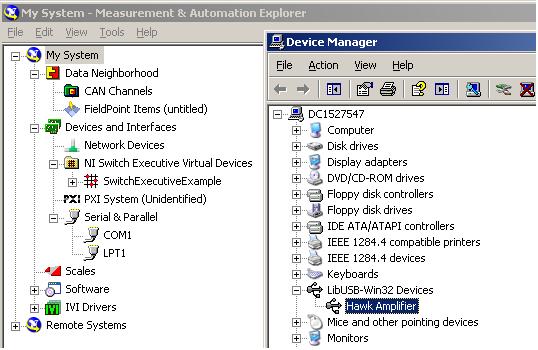

I do want to communicate with an  Atmel at32uc3a1512 as a device using USB, and I do have detailed information on how the device
sends, receives, and processes data, but I am not sure how to get Labview t orecognize this hardware...
I looked at the USB Instrument Control Turorial that you recommended in your post and viewed the
video on getting started with Instrument Control using USB but it showed an actual USB device in
the device manager USB section while my device does not show up in my Mac (v5.0) as shown below:
I still have to read about USB-RAW and the embedded ARM material...
