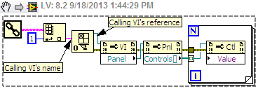

You could get references to all of the controls on the main VI's front panel and operate on them:
You'll probably have to add logic to identify the particular controls you want to manipulate.  You can do that with the Label property.
