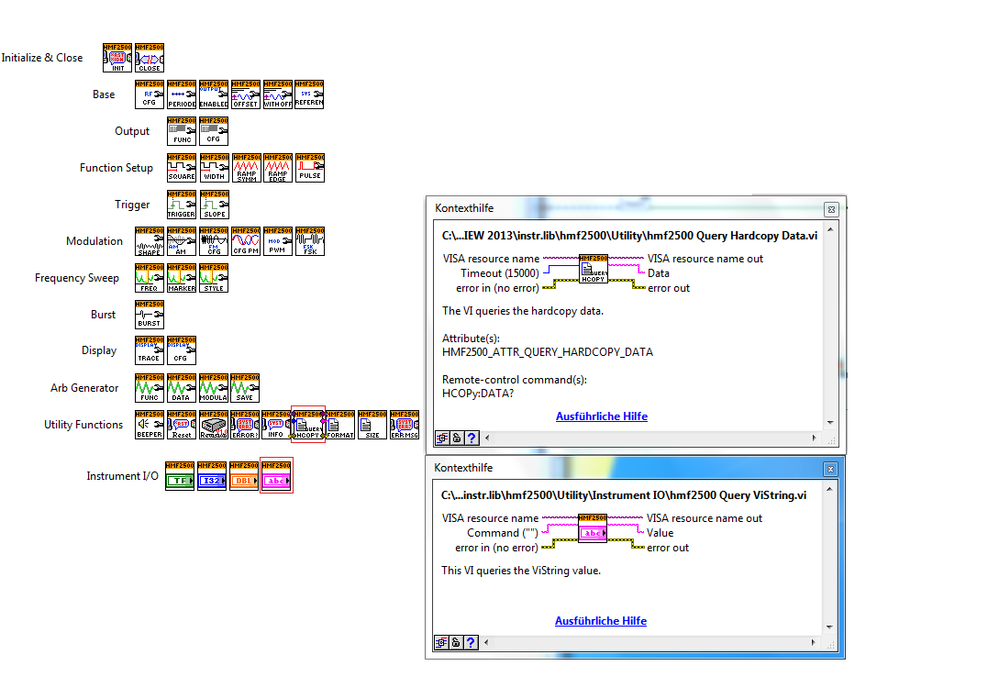

these are the Visa functions that i have the possibly relevant ones are highlightedhameg driver VIs.png

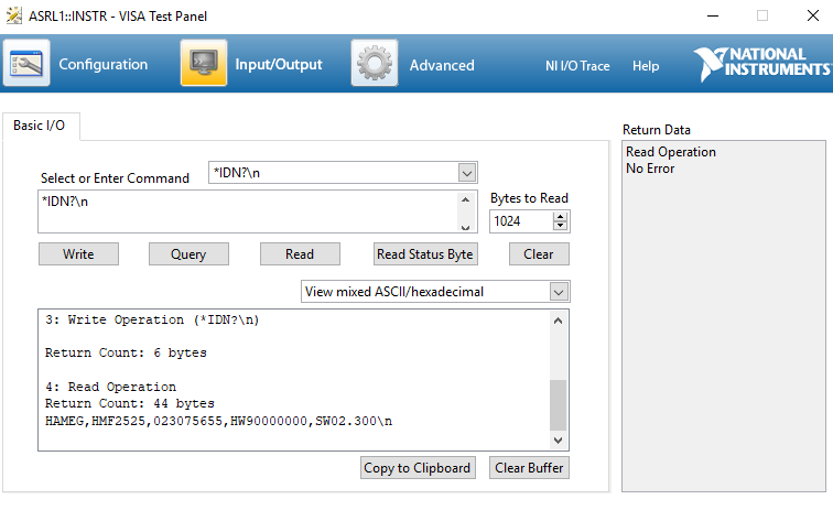

when i click 'open testpanel Visa' i get this :
Error opening resource:
ASRL1::INSTR
VISA: (Hex 0xBFFF0072) The resource is valid, but VISA cannot currently access it.
how can i fix this ?
but i still don't know how to visualise the functions on my generator ...

what I ment is to be able to see the generated waveforms in Labview , i didn't find a VI that could do this.
I know I could do this maybe with a DAQ but my boss thinks it's possible without  it.
all VIs in the library controll the generator but there is no VI that gives any information back from the generator (just the one I highlited)
the output function just controlls a button 'output' in the generator.
