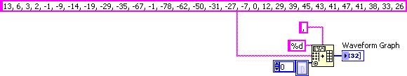

Use Spreadsheet String to Array. You'll need to strip the "Curve" part off.

So, what is the little thing connected to the bottom right terminal and where do you get it? I have never seen it before. Also, what kind of waveform graph are you using? The ones I find always come up as DBL.

It's an array constant. It's on the Array palette. Since your data is integers, I just dropped an I32 constant into it. That defines the type of data out of the function. The data type of a graph is whatever data type is wired to it.
