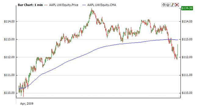

Data arrives in an orderly data stream and I would like to calculate the average of all data up until the current data point, which in itself moves with time. I would like to attain a graph similar to the example here;
