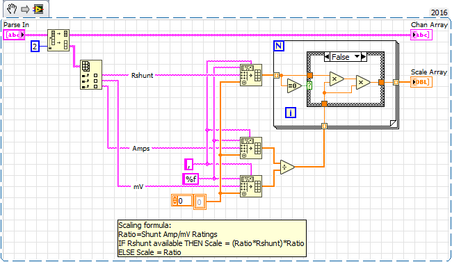

Here is VI I wrote for our ATE stations granted it's probably a little more complicated than you need but it should give you the general idea.
This VI gets it's values (Rshunt, Amps, mV) from a config file and the scaling factor is then entered into our data loggers (Agilent 34970A) and configures it to record Amps directly instead of millivolts.
Oh yeah, Rshunt is the measured resistance value of the shunt our calibration house gives us.

Appreciate the response. However, I do not know the shunt output in mV, only the shunt output in physical units, which is ft. lbs. Using your example, I don't know the denominator of my "ratio". Should I try to get calibration papers and see if they give mV outputs at the zero and shunt. Then use these two points to create a scale? I was hoping to only use the 100k value in ft. lbs to create a scale but it seems that I need the mV output to do this.
(3,512 Views)
