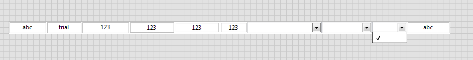

What if all ring elements in the array has the same properties? I've been trying to put a ring data into my cluster; which failed me so far.
In this short demonstration, string input works quite well where ring doesn't... Any thoughts?

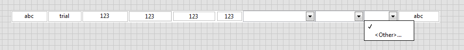

Hi GerdW,
I did it after your reply but couldn't get any progress still. I can set a ring without a problem but when I am trying to put it into a cluster, the problem happens.  After allowing undefined values:
Kind of confused here actually Smiley Indifferent Do you need me to post the code?

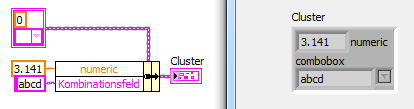

Hi Palazzo,
what kind of ring do you use in your "short demonstration"?
Rings have a numeric datatype, yet you store a string in your "ring"?! So I guess you use a combobox instead…
Comboboxes accept undefined values nicely:

Hi Palazzo,
in your example VI the cluster shows whatever I choose (or input) in the combobox constant.
So what's your point with the VI?
