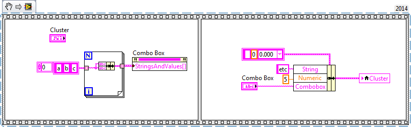

Hi Palazzo,
In next step, I will create an array of clusters...
In an array all elements share the same properties, so alll your comboboxes will have the very same string selections…
I can set combobox strings, when the box is in a cluster. See attachment…

Hallo GerdW,
This is working, actually this was what I needed in the first place. Since local variables of controls, which are put in the cluster, disappear; I was thinking that property nodes would do same.
Thanks a lot!

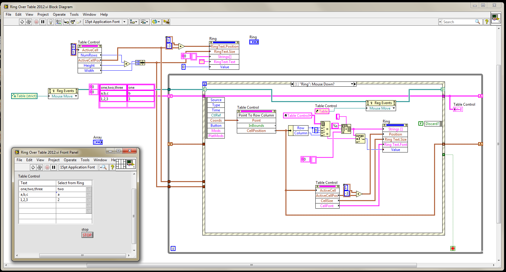

Palazzo wrote:
Thanks for the reply. I would be really interested in your new study about this tables, so please post it here if this is also OK for you.
Making it big seems a good idea to eliminate clicking the "right spot".
Here's a quick attempt. It's a bit hacked together so it's not as visually pleasing (code or front panel) as it could be, but it demonstrates the idea. There's a two-column table. The first column has a list of options separated by commas; when you click anywhere in the second column, you get a drop-down list of the options from the first column. The drop-down arrows are just for aesthetics; I used a disabled array of pict rings and you could definitely make it look better. There's one funny visual effect - looks like it's due to text anti-aliasing - that occurs when you drop down the ring but select the same value that was already selected. I'm sure there's a way to work around it but I don't have time to figure it out right now and it's not that noticeable. Let me know if you have questions or if you find it helpful.
