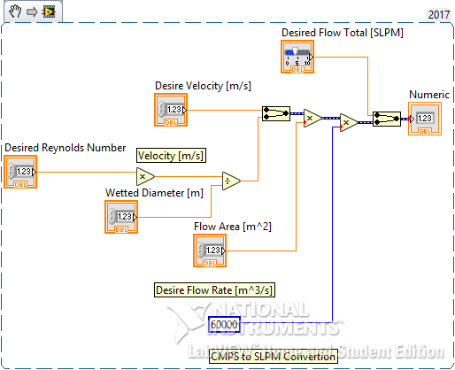

Hi guys,
I'm not 100% sure how to word it but I want to control the numeric inputs as so when user is inputting a value into a specific box, the rest would be grey out and be disabled.
Say the user input a value onto the "Desired Flow Total," the rest of the input would be grey out and disabled, allowing just a single value input... not sure if I'm wording this correctly or not.

What I want the system to do is that when I begin to input values into "A", the rest would be grey out and not have any input into the rest of the system, but when I delete the value in "A", the rest would become available to me once again.
The expectation is that at the end of the numeric display, when I input value into A the display would show that exact value, and the same goes to the rest of the groupings as well (since B and C would be a math function requiring multiple user input)

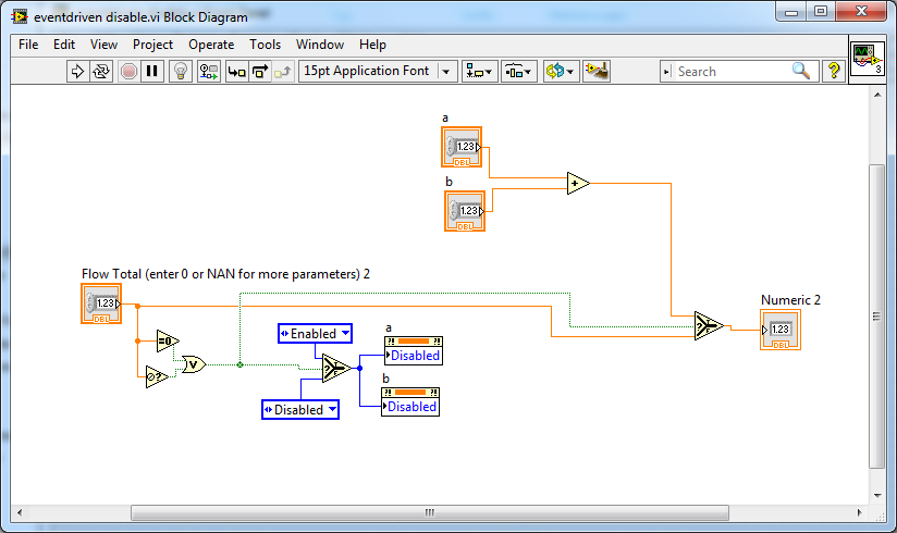

Another example of the BAD BAD dynamic datatype 😄
I would try to solve that with a event driven state MC  an extra control for the decision    or   .. see example
