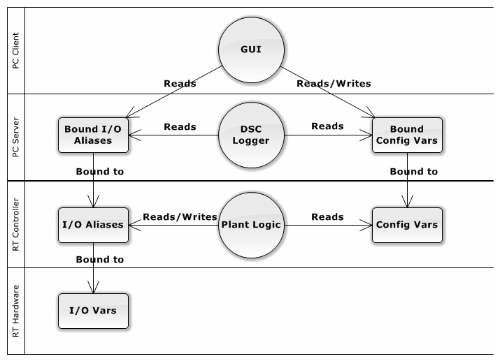

I/O Variables are grouped physically by chassis and module, not by purpose. My current project is a plant controller, using 3 CompactRIO chassis (linked by EtherCAT) and 20 C-series modules. The I/O ports for a logical part of the plant can be split across different modules (and even different chassis sometimes) -- thus physical grouping is suboptimal.
Here is our simplified system architecture:
We need variables hosted on the PC server for DSC logging, but also need variables hosted on the cRIO for robustness (e.g. in case connection with the PC server is lost).
We have 2 primary reasons to create I/O Alias libraries, instead of binding directly to I/O Variables:
  1. It lets us group the variables more logically, which in turn lets us simplify our code for programmatic variable access. It's an abstraction layer between the hardware and the code. The logical groupings also help our developers better visualize the system.
  2. The client has not finalized their specifications, and the I/O port mappings might change. If we use I/O Aliases, we can just change the I/O Variable that the I/O Alias points to, and that's it. However, if we bind directly to I/O Variables, changing the hardware mapping will require us to change (i) the controller code, (ii) the I/O Variable that the PC variable points to, and (iii) (technically optional, but needed for readability) the I/O Variable name
