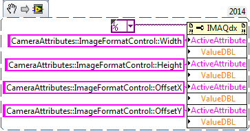

If you open your camera in MAX, there may be properties for the width and height. You can create a property node on your camera session and use these names as the "active attribute" and then set the "value" with a string or numeric.

That is the best solution. What I have reverted to doing was to capture video, then crop it outside labview, then process it by each frame
