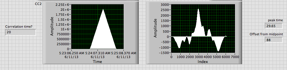

I think you may need to remove the large offset first. The raw data has a mean of about 25 to 26 with a signal variation of about 2 or 3.  The image below shows the cross-correlation of the raw signal as calculated by your code on the left and the cross-correlation of the signals with the means removed on the right. The signal on the right was filtered by Elliptic Filter.vi and the cross-correlation performed by Cross Correlation.vi from the Signal Processing palette. These calculations were performed on arrays extracted from the waveforms read from your TDMS file.  I did not use any Express VIs.
Lynn

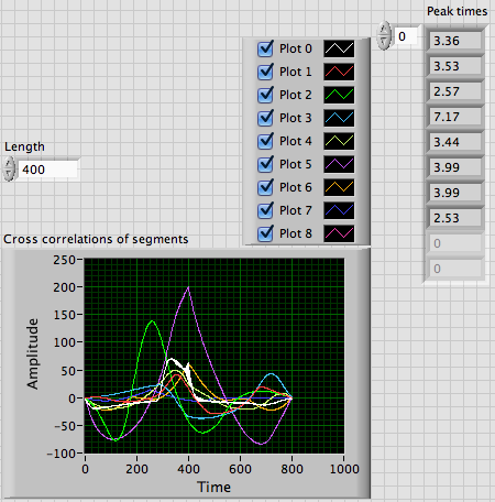

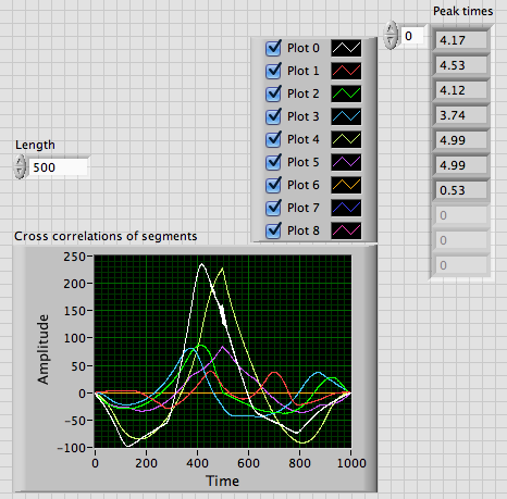

I looked at doing cross-correlations on segments of the data set and, as I suspected, the correlations and peak times vary substantially. The images below show the cross correlations and peak times for segments of length 400 and 500 samples respectively.
More to think about.
Lynn
