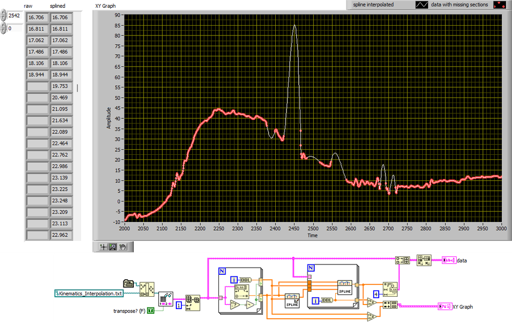

I am not sure if spline is the correct method, because the discontinuities near the gaps seem to create peaks that might be fake.
Here's how it would look like. (I took the liberty of simplifying things a bit since you only have one column. Note that I zoomed the x-axis to some interesting sections
(788 Views)
That is awesome!! Thank you so much!!
You mentioned that spline might not be the optimal choice since it might create unintended peaks. Do you have any other suggestions??
