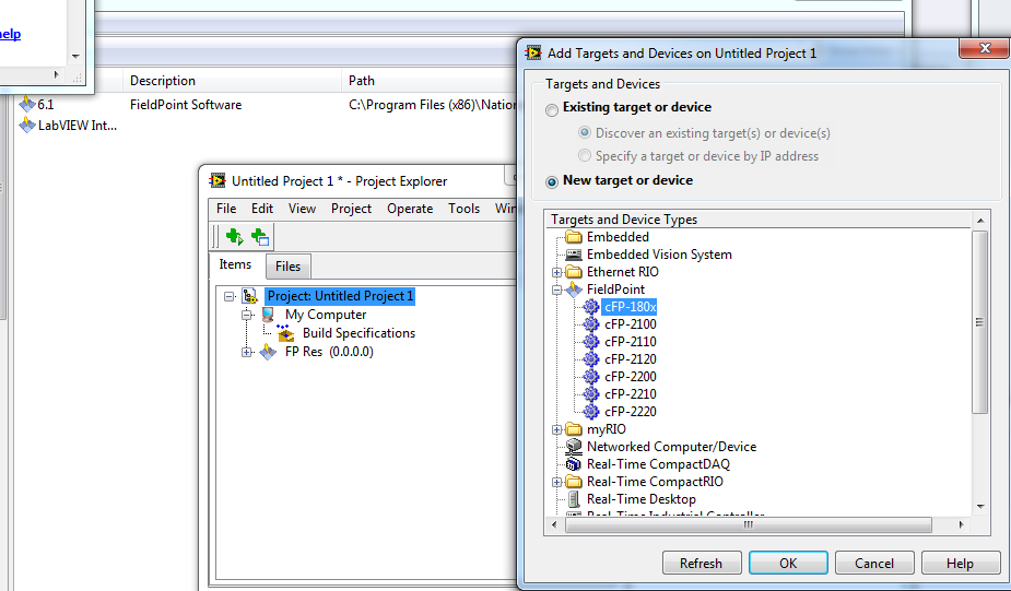

Curently using LabView 2013 is there anyway to use cFP-1808 with this version LabView?
How can I use older hardware that 2013 doen't support without uninstalling 2013 and going back to a version that does support it? I'm starting to wonder why upgrade when it will obsolete hardware you already own, Previous upgrades still showed older versions of LabView but 2013 doesn't.

Well, did you try the latest FP driver that supports 2013?
http://www.ni.com/download/ni-fieldpoint-6.1/4164/en/

Hello Rod,
If you install LabVIEW 2013 and FieldPoint driver 6.1, you should be able to add a cFP-1808 to your LabVIEW project. Did you reinstall drivers after upgrading to 2013? If you don't do this, cFP support won't be added to LabVIEW. Are you getting another error or warning when trying to recognize the target from LabVIEW?
