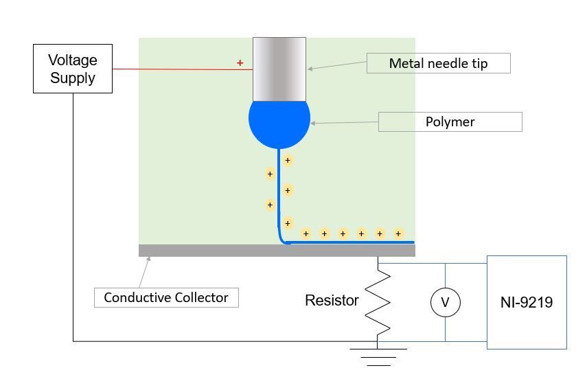

Hello, I am trying to do low-current measurement using NI-9219.
Basically, the current will be carried by the jet produced by a process called electrospinning (Please, look at figure).
The current will be from micro to nanoampere, so I think I measure the voltage drop across the resistor and then calculate the current using Ohm's law.
My concern is the setup design (Figure). If I follow this diagram, I am worried that the conductive collector causes serious measurement flaws as itself is a huge resistor since the current is very low (micro-nano).
I am new to electric stuff, so please be generous.
Thanks.

Thank you for the reply.
1. Maybe it sounds stupid question, but how input range of 25 mA give me 3 nanoAmps?
2. Then new diagram will be like this?

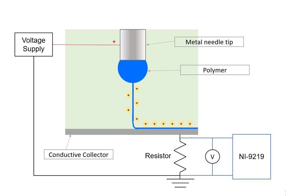

From other literature, they used this setup in diagram with the resistor of 20 Mega ohms. The measured current was about 0.04 micro Amp. So it gives me about 0.8 V.

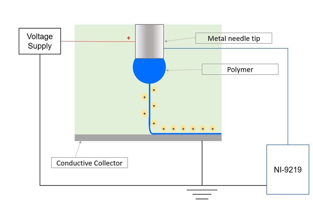

No.  Current is never measured on a parallel leg.  Current is measured in a serial circuit.  Your current flows from the supply V+ to the tool, to the collector plate, and then to ground, which is also your supply V- (COM) reference.  Just insert the NI 9219 current + and - terminals in line somewhere, so that all current also flows through the module.
