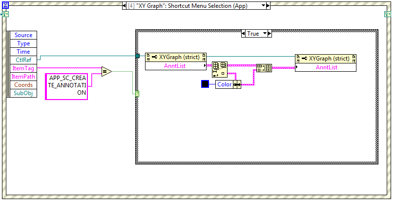

Not to drag up an old thread, but... searches brought it up (and another thread less useful), and a whole lot of nothing else.  I thought I'd add a solution for anyone else searching this. After some playing around, here is the simplest method I could find for changing the default color on annotations.
(7,368 Views)
Digging up this thread again since it's one of the top Google searches.
There is an event (at least, now there is) that fires when the user adds a cursor. It's under Shortcut Menu -> Cursor Menu Selection. It returns an ItemTag string of either CURS_FREE, CURS_SINGLE, or CURS_MULTI, depending on the type of cursor you chose.
