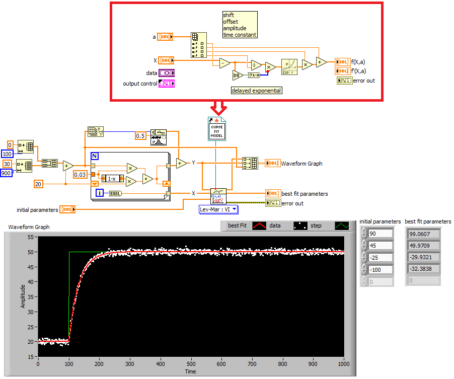

Here's a very simple way to fit a delayed exponential using conventional code (most advanced users stay far away from express VIs and dynamic data!)
Maybe it can give you some hints:
Message 4 of 10
(7,249 Views)

I eventually got this to work. I just changed the function in the curve fitting vi.
(This is a university assignment and the lecturer wants us to use express vi's - Not what I would use either but them's the rules)
Now to find the time constant...

If you "got it to work" and implemented the function correctly, one of the parameters is the time (or rate) constant already, depending on how you define it. (For example, the fourth parameter here is it)
