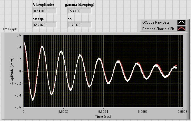

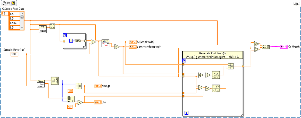

It seems you need to find the constants to your equation for x(t): A, gamma, and omega. I'm not sure if the other curve fit algorithms will give you those values. I used this code from some time ago using the Hilbert Transform to calculate the Q of a damped sinusoid waveform. I modified it slightly to generate your constants. Try it and see if it works for you.
I didn't calculate "C". By definition of equation, C = x(t) at t=0. That's your initial condition. I also added a phase shift "phi". I needed it to analyze my data. You may or may not need it for your data.

The non-linear fit VI that I'm using seems as if it could pretty easily fit a damped oscillation. I have been able to fit to mock data. However, it's not converging on a solution for some of my data at the moment so I used your Hilbert Transform VI. This seems to work alright, except it will need an offset term to be added. I'm facing the problem of getting damped components that are nearly 0. There is clearly a damped component to the data but the VI isn't picking up on it. I can attache the data if you'd like to take a look?
