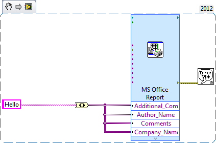

I did a test project and followed the instructions in this NI help file:
Report Help
and was able to generate an Excel report successfully. However, I did NOT wire a path control to the express VI. My path to the file was already defaulted in the Express VI itself (under the "Configure Save to File Options..." button). If that is what you also did, then delete the path control.
Here is my block diagram:
and the build specification:
Message 15 of 16
(1,901 Views)
