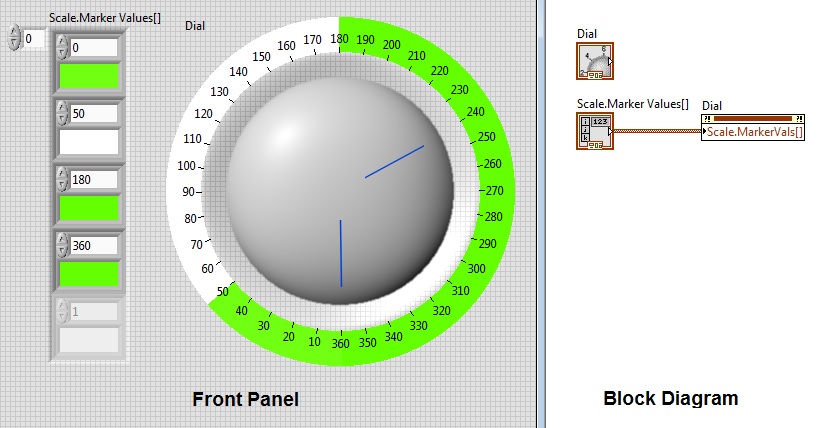

What you're looking for can definitely be achieved using the built-in color scale and MarkerVals[] property- you'll just need to track whether or not your valid range crosses 360 degrees and update the ranges as appropriate. Untitled.jpg
Tom L.
