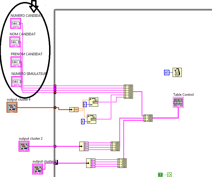

if we consider that i have 2 clients.could you modify the vi,or just a printscreen of what i have exactly to do .i'm really confused about the fixation of the number of clients and removing the cluster that is just indicator

yes thanks

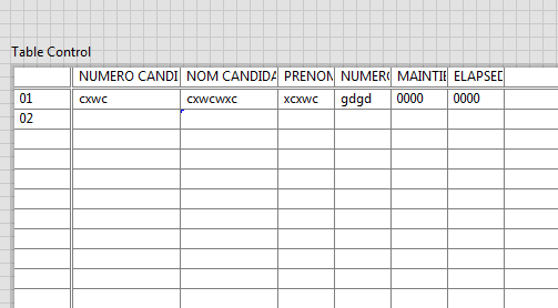

i think that i have to duplicate the code using a different address dstp5.png
if you have any suggestion to optimize the code,i'll be glad to hear it

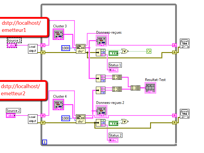

i still didn't get any result Smiley Sad  ,i don't know what to do to get result stocked in the 2nd row then 3rd one and so on1.png
what i have to modify in the block diagram below
Message 6 of 24
(6,118 Views)
You still have complete misunderstanding of dataflow. Even if these controls change, they will never get read by the code except at program start. If the controls should be read regularly, they belong inside the loop!
Apparently you now use databinding to update the controls. Here's how the code would look like after a minor cleanup. see if this works for you. It still requres a lot of cleanup and finetuning.

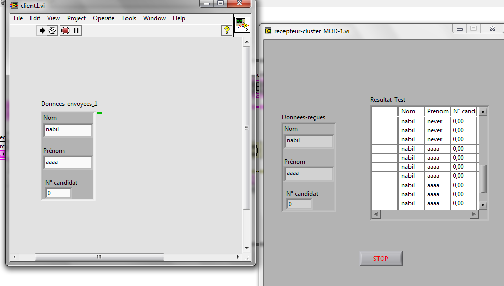

(6,067 Views)
It does?
What I see is the first set of data replacing the first row.
The second set of data (a cluster) replacing the second row.
The thrid set of data (also a cluster) replacing the third row.
Message 9 of 24
(6,051 Views)

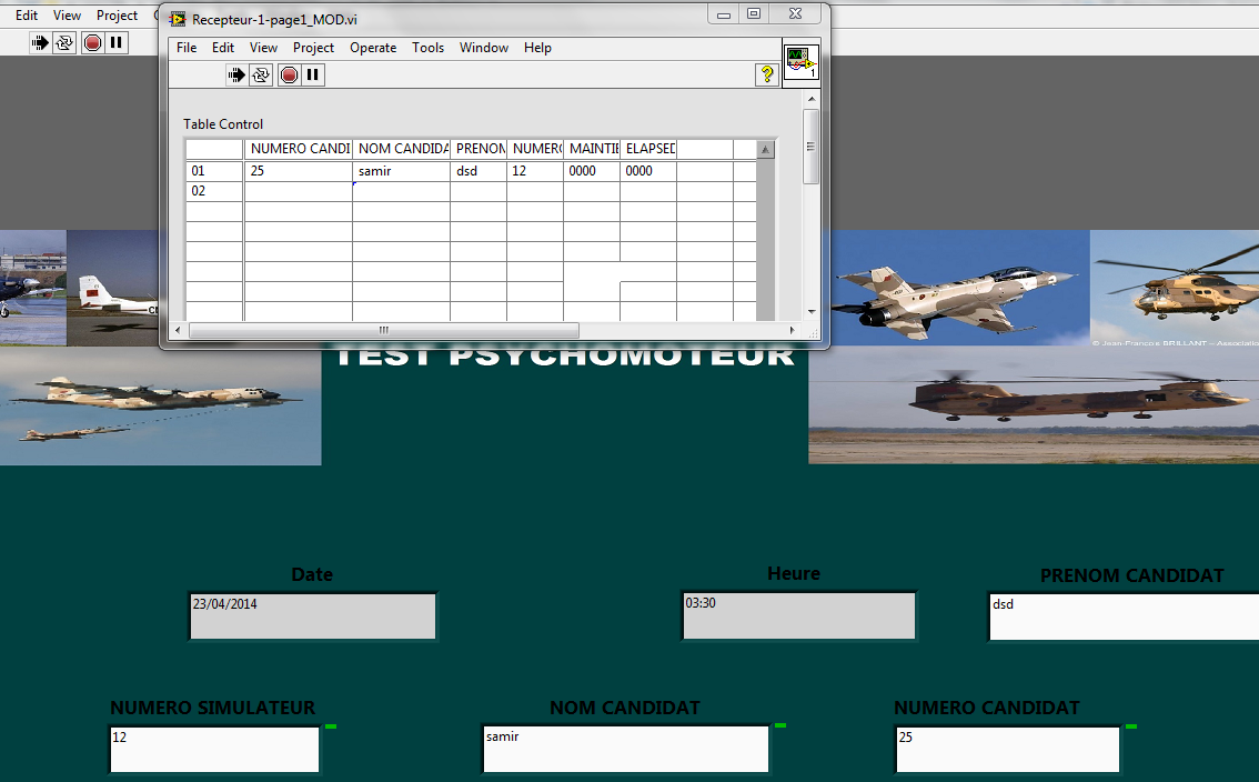

yes it does,i'm talking just about the 1st set of data,because normally other clusters are for other clients.the 1st set of data is for one client but whenever the user changes,the new one will enter new data but i don't want that it remplaces the 1st one.if there is any way to stock each data so i don't lose the old one2.png
