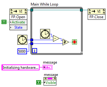

I am working on a vi that displays a message to the user and then closes after five seconds. When I run the vi itself it works fine, but when it is inserted into another vi the text does not display when the vi runs for the first time. Anytime after that the text will display though.

try making your message indicator, "visible" through property node

You have a greedy loop hogging the cpu and preventing the update to the indicator!  Toss any kind of delay in the while loop.

Woohoo! That did it, apok!
Thanks for the quick response!
Jeff, I understand, but there is not a delay in the loop. Should I build this vi without a loop?
Message 4 of 11
(3,534 Views)
Your loop really isn't doing much other than providing a very fast running, CPU hogging mechanism to put a 5 second dealy between the FP Open and FP Close.
If replaced the while loop with a single frame sequence structure, then put a Wait (msec) function in there with the 5000 wired to it, it will effectively do the same thing without burning CPU cycles.

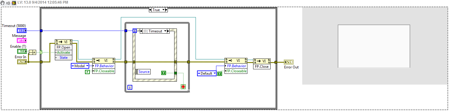

There are tons of ways to built that vi that do not have greedy loops
To be consistant with personal design guidelines I have mentioned around here from time to time, I'd choose something very close to this:

RavensFan, thank you for the reply and clear explanation. I have implemented your suggestion.
It still requires a property node for the message set to "visible", but that isn't a problem.
