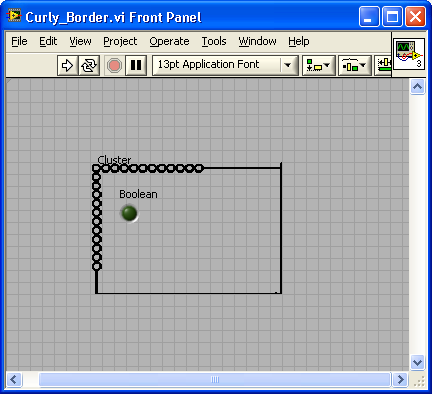

Here you go!
This zip has a very crude curly border along with the final results after importing the wmf file. This is only intended to illustrate the idea.
Ben

Well, got a chance to look back at it, and it turns out that I was doing it right - mostly. I just wasn't making the inside of the cluster transparent.
