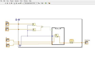

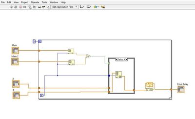

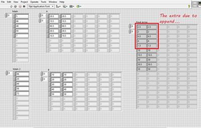

                I have a problem when I run this VI for the second time... I am not getting the answer I intend to get... I think the problem is the append function... What else can I do to get my intended answer????
Let me explain what I'm trying to achieve:
                         Main and Main 2 are a single dimension array whereas A and B are 2 dimensional... I would like to compare the Main and Main 2 row-wise and if Main is greater I would like to take the same row from A and if Main 2 is greater the row of B should be written... This must be done 5 times in one run... When run for the second time I would like to have only 5 rows in the Final Array... But I get 10 due to append but I'm not sure how to achieve this without append...

Your feedback node is uninitialized hence it will retain the data from the previous execution.
Add an empty array to the Initializer Terminal.

The main problem is that your code is way too complicated because you have not learned auto-indexing yet.
Here's the same functionality:
(Now the number of iteration will be determined by the shortest array. No need to wired N. You would need to use index array if one of the arrays is short and you want to pad with zeroes if it runs out of elements, but in that case, N should be determine e.g. by the largest array in the indexing dimension. If the sizes are large than 5 and you only want five rows in the output, you can just wire N again.).
