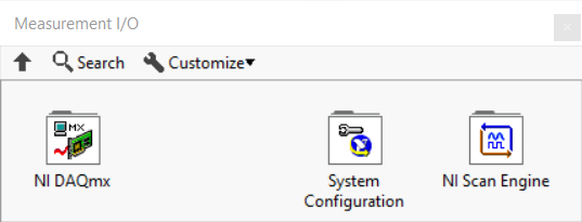

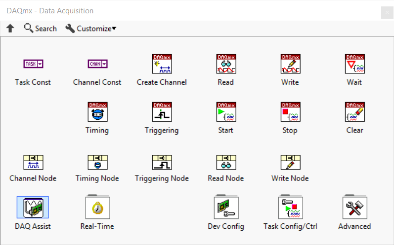

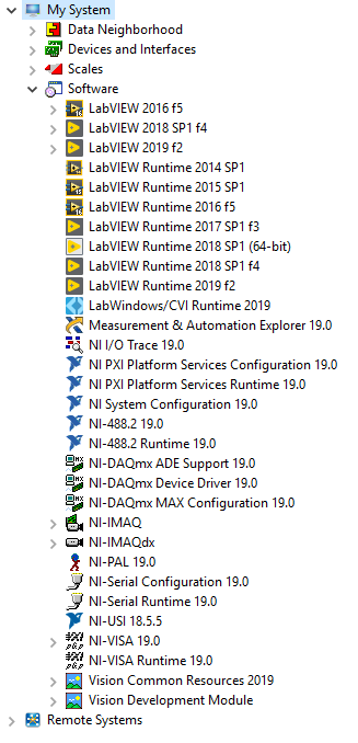

For reasons that are too sad to go into, I recently (the day before yesterday) removed all NI Software from this laptop (running Windows 10 x64, Version 1803) and reinstalled LabVIEW 2016, 2018, and 2019, using the Drivers downloaded from NI's Software Download site.  I installed DAQmx, 488.2 (because it insisted), VISA, PXI Platform Services, and IMAQdx.  Here's the list of Software from MAX, the Measurement I/O Palette (showing DAQmx), and the DAQmx Palette (showing the DDA in the lower left hand corner).  If you are still having difficulties, why don't you post similar shots of your system so we can "get a clue" ...
Measurement I/O PaletteMeasurement I/O PaletteMy System (from MAX)My System (from MAX)DAQmx PaletteDAQmx Palette
Bob Schor
P.S. -- I failed to notice I was replying to a three-month-old post.  However, I am describing a recent "fresh install" that got me the DAQ Assistant with no difficulty.  I also see another user has recently posted some "tricks" when dealing with LabVIEW 2019, the most difficult version to install I have dealt with since LabVIEW 2011 ...
