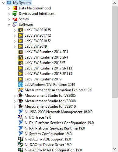

Can you post a screen shot of the Software Tab in MAX?  Something seems to have gone astray somehow ...

Why do you ask? I want DAQ Assistant and I don't get it with LabVIEW 2019. Even NI DAQmx is missing. I have also tried to reinstall Drivers DVD 19.1. Maybe I have to wait for the next DVD?
