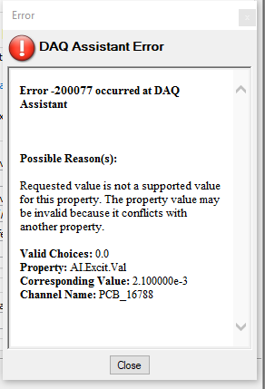

For example, if I now want to change channel 4 from a Voltage Input Setup to a Sound Pressure Setup, it gives me the following error:
What can I do to solve this problem? I have already tried to create a new DAQ Assistant, but it shows the same problem. Is it not possible to measure 5 pressure signals on a NI USB-4432?
You solve this specific problem by NOT changing to "Sound Pressure" measurement mode, but stick with voltage measurement!

Edit: after reading the short explanation here I guess you try to use the 5th channel which exhibits less capabilities as the other 4 channels of your USB4432…

You can use an external device to supply the IEPE constant current power to your microphone and AC couple the sensor output. See a device such as this (https://www.pcb.com/products?m=480c02). You can then 'T' the signal into the 5th channel of each of your 4432 devices for purposes of synchronization. As GerdW mentions, use the scaling feature in DAQmx to convert voltages to sound pressure (Pa).
I also recommend moving your code from the DAQ Assistant to the standard DAQmx API for LabVIEW.
It might also be in your best interest to invest in some hardware that can meet your needs with less work on your part. For instance, a cDAQ chassis with a couple of 9231 devices or a few 9234 devices would give you more sound pressure channels with the ability to effortlessly synchronize them (in hardware) using DAQmx channel expansion.
